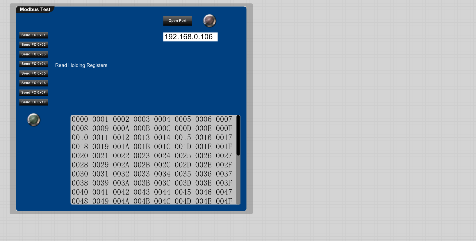

Here's my new Modbus TCP Client Test program.
Now included are all of the Function Codes to send and receive all types of data.
To test I used a Free Modbus Server App. http://www.plcsimulator.org/
Works a treat
Enjoy...

Re: Modbus
OK, here's the next version of the Modbus Client as you suggested.
In this version, I have simplified the UI to just write to 10 registers, with an address offset. The Hex values can by typed on screen or be sent to the module as inputs.
The read registers is similar with an offset etc. but this can be polled to automatically keep reading the given registers. The polling frequency can by changed using the provided knob. The read values are also sent out of the module as well as displayed on the screen.
There are also edit boxes for the IP address and port number.
I've not spent any time on the look of the GUI yet whilst we sort out the functionality.
What do you think?

Re: Modbus
The reading portion:
The reading is pretty much good to go. The polling works, you type in the starting address and the numbers populate the integers just fine.
The writing portion:
A couple issues. The first is parsing the input numbers. If the string is entered manually, for example, a "0004" for a number "4", the messaging works. If the number is entered in the INT input block, the string comes out "04" and doesn't send properly. Not sure if there is a block or object for this problem.
Is it possible to open up another client in flowstone? If so, then each function code could get its own message, and then maybe they wouldn't step on each other. Each server can have up to 10 connections. This is set up for 2 connections to each client - 1 for reading, 1 for writing. You can use one like you have, but you have to sequence the reading and writing through the single client.
Is multiple clients in flowstone only possible with Pro? If so, I guess we should stick with 1 and make that work. If not, then splitting them would make things easier to deal with. I think having a read object and a write object would be better if thats the case.
Overall, this looks pretty good. The reading section is awesome, and I could really crank that polling up. Most industrial controllers can poll at about 10-25ms, and this one I was able to crank down to about 25ms (40 reads/second). I think the writing is almost there, its just the input parsing that really needs fixing.
If you are able to do two clients, then even being able to poll separately would be nice. You could set the reading at one rate and the writing at another rate. To only write on change, I simply tied each input to the same write trigger.

Re: Modbus
I forgot to test the inputs - duhh
Anyway the inputs are now working correctly, and it seems no problem to have two or more clients so I have done as you suggested and split the read and write up. This does simplify things quite a lot as far as dealing with the error messages etc.
If the Write Client times out then the fist click on the write re-opens the connection and the second send the data.
