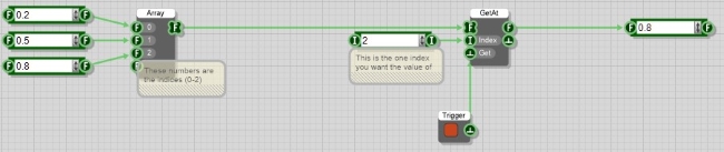

Matth23u wrote:I somewhat understand what arrays are, it separates multiple entries with commas which are combined and split procedurally.
But how can i convert a float array to multiple float entries so i can send them individually to different modules?
Is there some kind of array extract that works like BUS extract?
An array is a list of cells. The list is indexed from top (index: 0) to bottom (index: number_of_cells-1). Each cell contains a value (in our example floats). You access the value by telling Flowstone to look at the array at a position specified by index. The array splitter is not such a good choice, because it is limited to arrays with a maximum of 50 cells. You can use it on Arrays with more cells, but only the first 50 will be returned.
Here's a screenie that may make it more obvious.
The post above mine about using the text box is actually not a good advice. The array has to be converted to text and later back to float, in order to use the text box. This adds to the cpu load. And you gain nothing from it other than seeing the values directly, which isn't needed, as it is not Schroedingers cat. A value added to an array stays the same value, wether you look at it or not.
