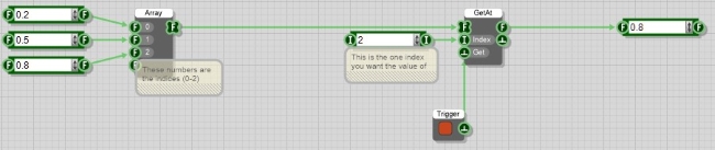

An array is a list of cells. The list is indexed from top (index: 0) to bottom (index: number_of_cells-1). Each cell contains a value (in our example floats). You access the value by telling Flowstone to look at the array at a position specified by index. The array splitter is not such a good choice, because it is limited to arrays with a maximum of 50 cells. You can use it on Arrays with more cells, but only the first 50 will be returned.
Here's a screenie that may make it more obvious.
