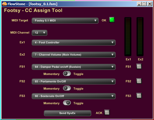

Here's a very simple project I built to control a Teensy-based MIDI controller with a few bytes of system exclusive messaging. (The controller is just a box with a Teensy and some 1/4" sockets for up to three foot-switches and two expression pedals - since it's Teensy-based I'm calling it 'Footsy'.)
The message instructs the controller which MIDI channel and which CC numbers to communicate through.
The message consists of the start and end sysEx bytes, a four-byte Key and 9 bytes of program data.
Selectors generate the main 'message' part of the sysEx string (9 hex bytes)
1 - F0
2 - 7D
3-6 - Key
7 - MIDI channel (1-16)
8 - Ex1 CC
9 - Ex2 CC
10 - FS1 CC
11 - FS1 0=momentary / 1=Toggle
12 - FS2 CC
13 -FS2 0=momentary / 1=Toggle
14 - FS3 CC
15 - FS3 0=momentary / 1=Toggle
The code in the controller sends back a three-byte ACKnowledge message "F07DF7" which displays on the panel.
The indicators on the right-hand side let you see the controls are working as expected.

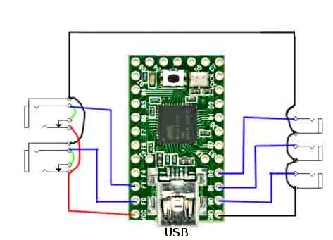

Here's all that's inside the box:
Unfortunately I couldn't find a TRS that had a switch on the Ring connector at my local electronics store so this pulls the analog pin on any unused EX pedal socket to VCC instead of ground but the device-code will only send a CC=127 msg if you're connected when you unplug. [EDIT - this is needed to prevent the pin's voltage from 'floating' and generating garbage messages. You have to pull it to one side or the other when not in use.]
