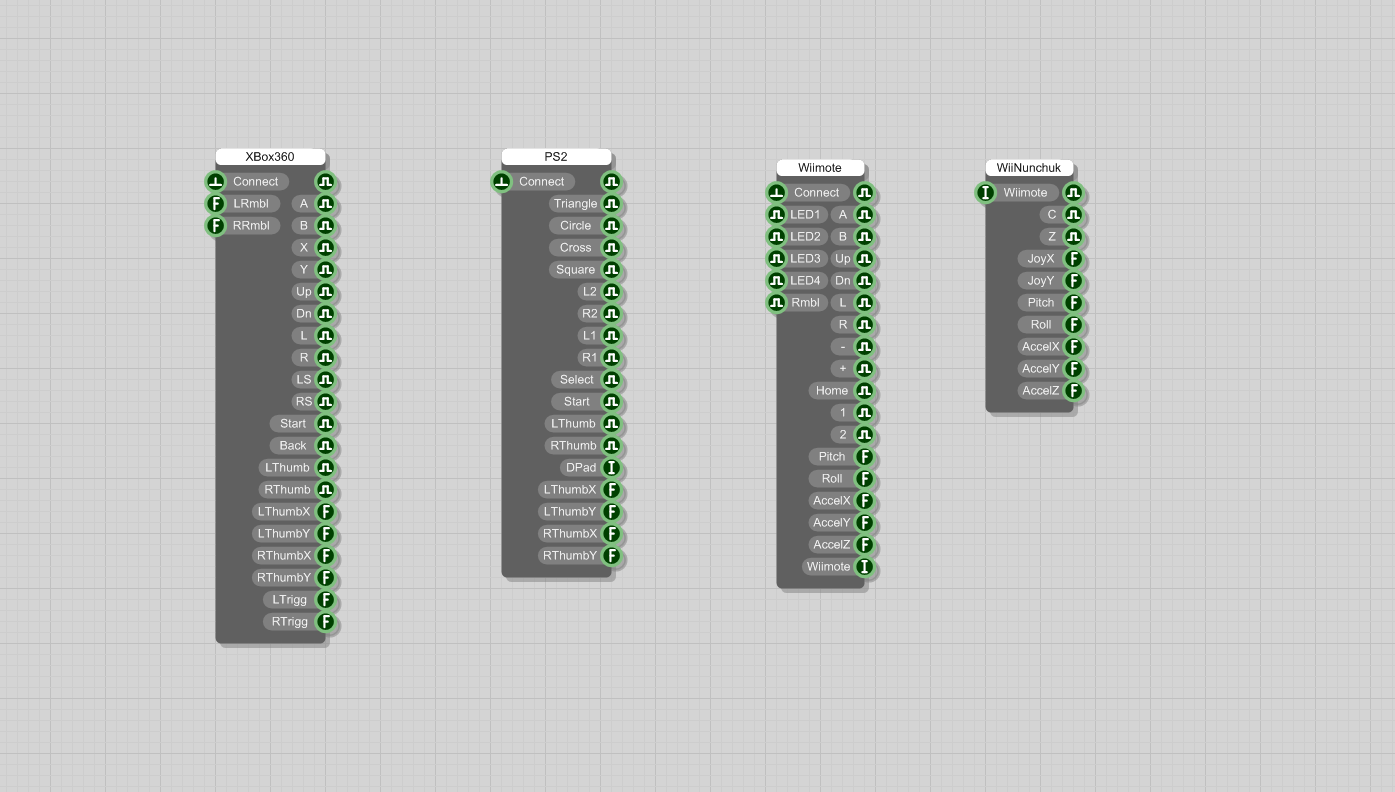

I would just use an Xbox controller or a PS2 controller (from LynxMotion) as these are already fully supported. Another option would be to use the Wii Mote:
Games Controllers.png (123.63 KiB) Viewed 19368 times
