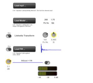

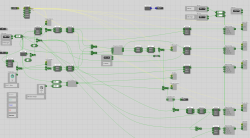

The aim is to show how simple and effective DSP is, when applied to speakers.
Let's begin with the Speaker Lab Player. This is a simple .mp3 player featuring :
- BiQuad IIR filter
- FIR filter
- A/B switch
- VU-meters
Currently, I'm using Logitech z120 speakers. For reproducing the experiment, you need those speakers. They are widely available, and inexpensive. This is the only required hardware for running the Speaker Lab Player.
The BiQuad IIR filter serves as Linkwitz Transform, compensating the low frequency resonance and deep bass 2nd order high-pass attenuation of the closed-box speaker. In case you don't know what's a Linkwitz Transform, please check section 9 here http://www.linkwitzlab.com/filters.htm
The FIR filter serves as linearizer above 300 Hz or so.
The dB knobs are there for equalizing the listening levels.
The A/B switch enables you to compare the unprocessed sound against the processed sound.
The VU-meters are there for showing if you get close to digital saturation.

- Speaker Lab - Player v1.fsm
- (29.12 KiB) Downloaded 1784 times
- Speaker Lab - Player (400).png (28.93 KiB) Viewed 59427 times

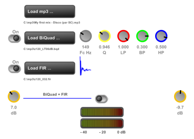

Here are a few z120 BiQuad filters you can select as Linkwitz-Transform.
Unzip the file in the directory where you have the .fsm.
Select one of those BiQuads upon pressing the Load BiQuad ... button.
The BiQuad labelled as MODEL is not to be used as Linkwitz Transform.
Such file is there, only for documentary purpose.
This is the BiQuad modelling the z120 resonance and low frequency roll-off.
Here are a few z120 FIR filters you can select as linearizers above 300 Hz.
Select one of those FIRs upon pressing the Load FIR ... button.

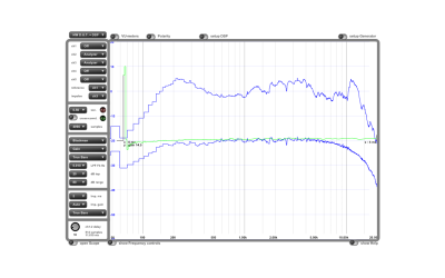

Here are the z120 frequency responses, uncorrected (above) and corrected by the BiQuad + FIR (below)
The green plot is the impulse response, when corrected.

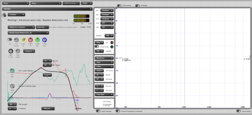

Now comes the time to tell how the various FIR filters got designed.
This is very simple indeed.
1.
Decide about the target response curve, the one from the Logitech z120 after they get corrected.
Say you want a 2nd order lowpass, Butterworth, with a cutoff at 10 kHz or so.
You need to compute the corresponding impulse response and use it as reference.
For getting such impulse response using Flowstone, use the "Impulse" primitive, send the signal into a 2nd order lowpass Butterworth (one BiQuad), and grab the output using the signal "Analyze" primitive, grabbing the 256 first samples, storing them into a Float Array. The longer the grab, the more precise the correction will be. Grabbing 256 samples at a 44.100 Hz sampling frequency means a 5.8 ms signal duration. There is no use in grabbing more samples. Grabbing more samples, we run the risk embedding signal reflections into the grab. If this is the case, on top of correcting the loudspeaker emission, we will correct the room resonances. The issue with correcting the room resonance, is that the correction will only be valid at a particular listening point.
2.
Compute the impulse response of the genuine Logitech z120 speakers, using the 5-channel FFT-based Audio Analyzer described in another thread on Flowstone forum. Setup the analyzer for a 256-tap FFT. For doing so you need a mike, a mike preamplifier, and a loopback cable.
3.
Translate the two above impulse responses into the frequency/phase domain using a 256-tap FFT.
4.
Compare the target gain/phase with the Logitech z120 gain/phase, frequency bin per frequency bin.
As the FFT is a 256-tap one, you get 129 frequency bins, each outputting a gain value, and a phase value.
Such comparison is the design sheet for the super-resolution gain/phase equalizer that you are going to build.
For each frequency bin,
- the gain correction equals the target gain divided by the Logitech z120 gain
- the phase correction equals the target phase minus the Logitech z120 phase
5.
Translate the correction gain/phase into time domain using a 256-tap iFFT (inverse FFT).
This is the impulse response of the correction.
Wait a minute ... "the impulse response" ...
Those are thus the coefficients of the FIR implementing the correction.
Job done.
This is the bare idea. For getting this working optimally, two extra-features need to be added.
6.
The FIR filter, having a frequency resolution equal to Fs/N (Fs=44.100 and N=256), cannot correct the bass range with a decent precision. With a 256-tap FFT, the FIR can barely make a difference between frequencies that are 170 Hz apart. For avoiding the FIR to apply a correction at the lowest frequencies, we need to apply a "mask" before generating the filter design sheet. The "mask" simply consists of specifying that the correction gain will be 0 dB and the correction phase will be 0 degree for the first frequency bin, or possibly for the first and second frequency bins. This way the FIR only introduces corrections above 300 Hz or so.
7.
The FIR, materializing an impulse response having a finite length, may be associated to a proper "window" putting the emphasis on the leading edge. This is important, as the leading edge contains most of the energy in case of an impulse response, on which everything gets based here. The aim of the "window" is to progressively extinct the impulse response trailing edge, whatever the design sheet asks for.
Attached are the control screens, visualizing the various impulse responses and correction needed.
- green curves : genuine, uncorrected Logitech z120
- blue curve : target, obtained from stage 1
- red curves : corrections required from stage 5, actually there are two sets or red curves, the non-windowed correction, and the windowed correction.
- black curve : corrected Logitech z120.
Now you are watching, what you just listened at.
You know where the FIR filters are coming from, and how they got designed.
Remember this is the design stage.
When listening to the music, the above scheme is of course not executed. The only thing that gets executed when listening to the music, is the resulting 256-tap FIR filter, the one that you select using the "Load FIR ..." button in the Speaker Lab Player.
Steph

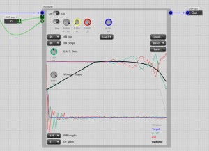

Re: Speaker Lab
Want to experiment the Speaker Lab - Designer ?
Here is the corresponding .fsm
- Speaker Lab - Designer.fsm
- (635.19 KiB) Downloaded 1668 times
- FIR design - impulse - FFT & compare - iFFT (500).png (88.38 KiB) Viewed 59484 times
Re: Speaker Lab
Interesting. One question: how flat is the mic frequency response? Do you need a dedicated, expensive device?
I haven't actually listened, but by the look at your spectra it seems that with the 10 kHz Butterworth LP you are cutting treble perhaps more than necessary. Could that be a reason for your first perception of the processed sound as dull?
Re: Speaker Lab
Hello Martin, yes indeed, you are right.
The correction made by the FIR filter is function of the microphone transfer function.
The Butterworth target lowpass in the FIR filter design got setup on purpose, for avoiding the FIR filter asking for gain in the treble range extremity. Look the tiny red curve.
A factor explaining the corrected sound appearing dull, may be the polar radiation pattern of the Logitech z120, quite directive above 5 kHz due to the membrane diameter, larger than a dome tweeter. The measuring mike that's just in front of the Logitech z120 speaker pickups a certain amount of treble energy, however at an offset of 30 degree or 45 degree, the treble energy is much lower. Bear in mind that the ear is integrating the sound coming from all directions. In a normal living room, as soon as you are not just in front of the speakers, the reflected sound contribution may become dominant. Treble will be in deficit, when dealing with a directional speaker.
Such theory may explain the addictive attribute of listening the Logitech z120 like headphones, only 5 cm away from the ears. Listening this way, you'll find nobody qualifying the corrected sound as dull. Your ear is now at the place of the measuring microphone, and the reflected sound contribution becomes negligible.
I won't comment on the measuring mike and preamp, beyond the fact that this is an electret condenser mike factory wired as 3-terminal (not the usual Panasonic WM61A tweak), hooked on a standard low noise preamp designed and made by me, powered by a 9V battery. I just bought a few Panasonic WM61A on eBay. Someday I'll make detailed comparisons, hoping they are not fakes. I also have the Behringer C-2 and B-5 at disposition (20 mm condenser capsule needing phantom power), hooked on a USB audio interface featuring the mike preamp and phantom power. This is all standard, affordable audio gear, nothing esoteric.
Re: Speaker Lab
This is Player v2.
- Speaker Lab - Player v2.png (18.67 KiB) Viewed 59364 times
- Speaker Lab - Player v2.zip
- (837 Bytes) Downloaded 1696 times
- Speaker Lab - Player v2.fsm
- (30.33 KiB) Downloaded 1681 times

Here is Speaker Lab v1.0.
There are two different incarnations.
DSP before DAC
One can hear and see the correction.
The DAC to ADC latency needs to be compensated.
Unfortunately, such latency is hard to compensate, as it exhibits sudden variations when Windows must process audio as background task, and at the same time write a file to disk or draw many lines on the screen.
DSP after ADC
One can see the correction, not hear the correction.
The DAC to ADC latency doesn't need to be compensated.
DSP before DAC
DSP after ADC
- Speaker Lab v1.0.png (41.27 KiB) Viewed 59363 times
- Speaker Lab (DSP before DAC) v1.0.fsm
- (565.4 KiB) Downloaded 1648 times
- Speaker Lab (DSP after ADC) v1.0.fsm
- (1.11 MiB) Downloaded 1801 times

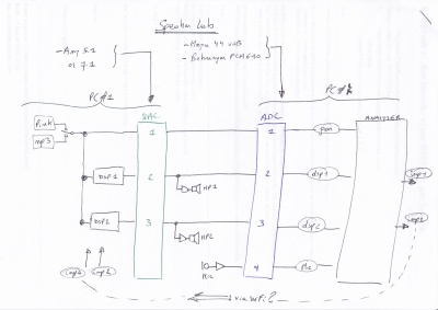

Re: Speaker Lab
Client/Server Speaker Lab, running on two separate computers.
The advantage : both x86 PCs can have relaxed specifications.
The disadvantage : need to setup the corresponding TCP/UDP Flowstone blocks ...
p.s.
As the DC doesn't get conveyed through the reference channel, one need to be careful with the first frequency bin.
A possibility is to rely on the Client -> Server data link for conveying the missing piece, however the Client -> Server latency will cause trouble, and even more trouble will be caused by the USB+DAC+ADC+USB latency. The DC bin arriving through the Client -> Server link won't correspond to the actual audio data, sampled by the ADC and sent to the Analyzer using USB.
p.s.
