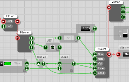

I made a schematic but it bugs.
I thought it would be great if i could do such a thing as i'll explain:
"Get time position and beat offset and according to the position of each not that is inputted, fit it to grid and if it's earlier, double-tap, if it'S even earlier, tripple-tap".
I'll show you what i've done yet, and i assume it'S probably way cheaper than what you would've imagined.
I use a time-fitted ticker in which i added some non-sync bpm division making the ticks somewhat, at least match the speed if not the sync.
I guess there's something wrong with note-off... Or something.
The more it runs, the more likely it is to send "c++ error" messages and crash FL Studio.
For the moment, the plugin runs like this:
I input imitone midi output as P1. I input it in the plugin as P1 and output it as P255 (Could be P2, there's a selector).(Oldschool pre-ruby prims made, like the old days)
Ticker emits a note at default pitch through the few midi modules, by some wizardry.
Notes also passes through, but like i said, i'd like to be able to manage the notes, stack them to the closest time division and use the time-difference as a way to make multiple-taps and somehow play drums with an arp later in the midi chain, outside synthmaker. That's why i want to fill time. And also to control vocoders!
But before i'm even there, i need to figure out how to prevent those c++ error prompts. If i catch one anytime soon, i'll EDIT and "Quote" it.

I'm still trying to make something out of this.
The error i get is "this".
Every note played adds another pop up.
It happens when receiving notes through midi from imitone.
I'll try with "scores".
Strangely, it doesn'T crash when using mixed "scores" and ticks.
What's different from notes sent from "Fl Midi Out" and those from Imitone?
How could i, somehow, make notes played between each ticks just "stack" in a chord? Or be "quantitized" between ticks?
I realize that the bug is less common when i run imitone from inside FL... Maybe the issue is closer to FL or Imitone themselves than flowstone... But imitone causes no issue without Flowstone so maybe there's still something to do with flowstone after all... But that's a particularity, that using "imitone vst" isn't as crashy than using the standalone imitone. I guess i should link-back to this thread on imitone forums.
Tho, you guys mentioned i could do all of this stuff with Ruby... How could i get something similar to this and even more with simple ruby-newbie expressions?
