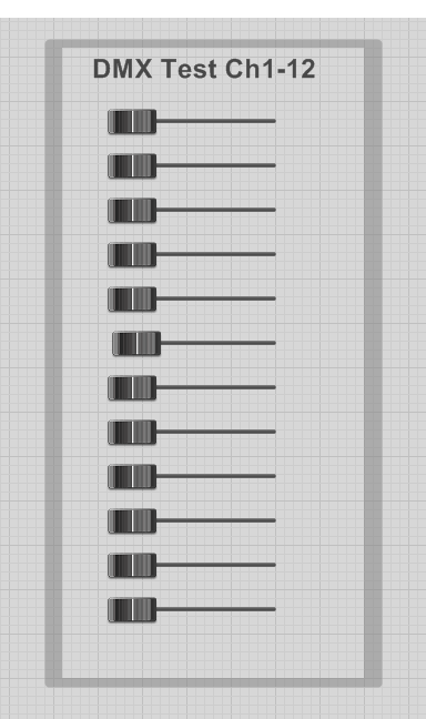

The DMX protocol is quite simple from the FlowStone side sending out a strings of Hexadecimal bytes (upto 512), each byte represents a DMX channel:
Here is a 12 Chanel lighting mixer:
DMX Disco Light Faders 12 clip.png (27.23 KiB) Viewed 95707 times
