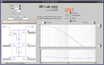

I'm attaching :
- a .fsm, with a few cosmetic changes, which is the one implementing the Ruby "True Averager", with your nicely commented Ruby code. This is very pedagogic. Thanks.
- a .jpg screenshot of IIR Lab mini, a little program I made using MS Visual Basic for calculating IIR filters. For duplicating your IIR lowpass, I have set a 44100 Hz as virtual sampling frequency (it should be 10 Hz, but the program doesn't allow such low value), a 1st-order, and a 360 Hz frequency. The "LP" coefficient must be set to 1, and the "HP" coefficient must be set to zero (this is a pure lowpass). On the schematic, you get all IIR coefficients properly displayed. Why 360 Hz here ? Because 44100 Hz multiplied by 0.0825 = 360 Hz roughly.
- a .zip containing the install files for IIR Lab mini.
Steph

I'm attaching :
Steph

I like it very much, and I'm using it for modeling digital audio IIR and FIR filters. See the attached .zip, containing the roots of a LTspice-based graphical audio compiler, for any kind of audio target, like a PIC32 based board, or a ARM Cortex-M4 based board. I'm exploiting the LTspice netlist.MyCo wrote:How do you like LTSPice?
- Implementation A : what we send to the microcontroller is the bare LTspice netlist in text format. Inside the microcontroller, we have an embedded application parsing the netlist, recognizing the part list names, having their prototype object code in Flash memory, instantiating them in a structured way, and establishing the signal flows (nothing else than pointers) compliant with the netlist.
- Implementation B : what we send to the microcontroller, is PIC32 or ARM Cortex-M4 precompiled executable code to be copied into RAM, to be executed without parsing it. This scheme allows an ultra-thin target, without any OS or application, only requiring a bootloader in essence.
What's your opinion on this? I'm attaching a .zip as preliminary illustration. Those are LTspice files to be installed into a same directory.
