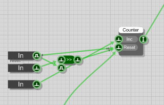

The general Plan is for a ruby module with in's/out's like these.
I don't mind spending the next 6 months, chipping away at this..... all good...great fun
It's just that a "counter" is a "crucial" building block, and i thought it might be better
to create it faster, so people can get on with more important stuff.
