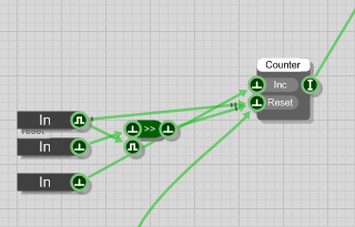

The general Plan is for a ruby module with in's/out's like these.
I don't mind spending the next 6 months, chipping away at this..... all good...great fun

It's just so weird. I got a signal going in, and all i want to do is stick a number on each signal.
And I still can't do it.... :lol: :lol:
I'm glad I've got Nix's example, which clearly shows a method that semms to work, so i can work of
that a bit.
It's just real dissapointing I still can't work out how to do it on my own.
