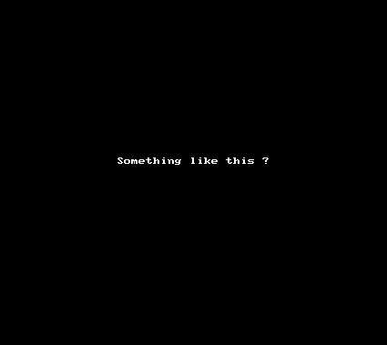

You mean the wet/dry knob ?
Re: Single knob/button Equaliser
Posted: Sat Oct 06, 2018 8:40 am
by lalalandsynth
Like this ?
by lalalandsynth
Like this ?
I would share the schematic but i am working on another version of FS, hope this helps.
