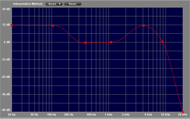

This is one of my current projects, a freely configurable filter. The user specifies a transfer curve in the frequency domain by placing control points, which are interpolated to give the desired transfer function. The application calculates FIR filter coefficients and provides a ready-to-use filter. The actual filter characteristic may deviate to some extent from the specification because the filter length is 1024 taps; longer filters have higher latency and use more CPU.

- InteractiveCurve.png (19.03 KiB) Viewed 41686 times

Brilliant! Has this been done ever before? A paint-your-own-filter? I don't think it can become any more versatile, or do I miss something?

Man ... this is so cool, MartinV.
Re: Freely Configurable Filter
Absolutely fantastic Martin!
You just draw the filter characteristics you want, and I totally love it.
I’m wondering if this could be used to accurately match a spectral profile for mastering somehow. Just thinking out loud.
