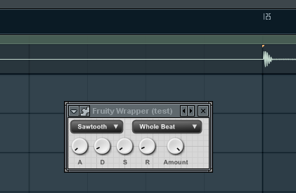

trogluddite wrote: PPQ Test 003.fsm
Tested in FL Studio. Great stuff Trog, but there's a small problem. She's dropping a few notes
here and there. These happen at regular timings, so there's your way in for the fix.
After about 5 min, your still right on the money, but the error still there
Your "Master Clock" theory sounds perfect. create it in one place and then distribute via ruby
through the schematic. Would also help to make FS "solid as a rock", and make it feel like it
was made out of cement.
