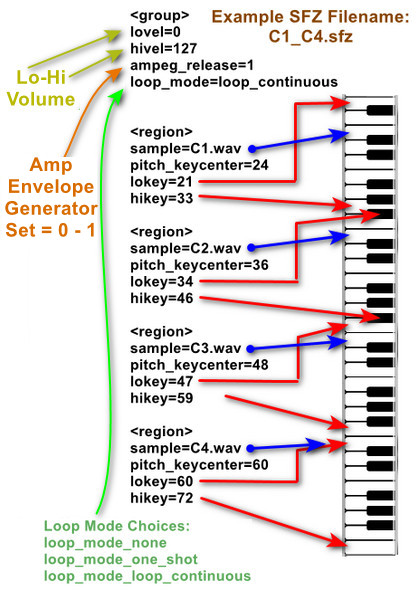

P.S. THERE ARE A ZILLION OTHER SFZ CODE PARAMETERS ALTHOUGH THE MORE USED THE HIGHER
THE 'CPU' (CENTRAL PROCESSING UNIT) DEMAND AND SOME MAY NOT FUNCTION WITH FLOWSTONE.
SEE 'WYSIWYG' SFZ FILE DIAGRAM IMAGE BELOW FOR EASIER
UNDERSTANDING: "A PICTURE PAINTS A MILLION SONGS"
