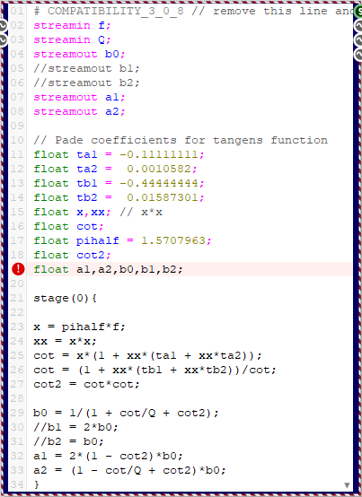

I have noticed that three of the cabs don't work (Green 25, Basket, and Recto), and I apologize because it is my fault. There is a bug in the coefficient calculation for the high cut filters (and in Recto, also for the highpass filter):
Please remove the offending line
float a1,a2,b0,b1,b2;
Apparently FS3 was more permissive than FS4 is. I still develop much in FS3, but I have made it a habit to always check with FS4.
