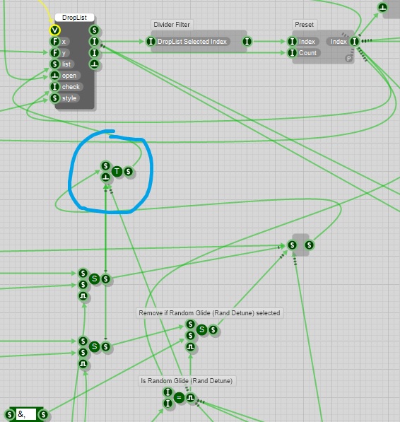

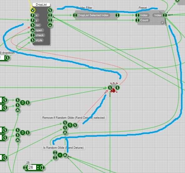

The Alpha thinks this is a problem, but old FS does not... So the logic would be that update to the list cases a trigger in the Dropdown prim outputs. But this isn't an issue with old FS?
Re: Question about green
Easily fixed with a S&H... But clearly a difference between FS4 and old FS.R&R wrote:The Alpha thinks this is a problem, but old FS does not...

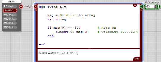

Guessing this is the only easy way of getting last played (midi received) note's velocity in green?
- Split_velocity.fsm
- (10.44 KiB) Downloaded 2666 times
Re: Questions / Things of green
Here is an alternative (FS User Guide p.219f):
(Note: To avoid confusion: The MIDI message displayed in the lower Ruby panel (Quick Watch) is not a "note on" but a "note off" message, hence the different velocities.
Note On: 93 (green output)
Note Off: 19 (lower Ruby panel)
I could not manage to sustain the note while taking the screenshot.

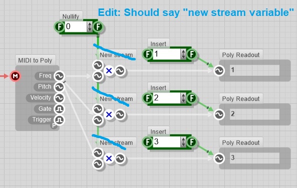

Could just sacrifice resources by using more Poly's and filter out by Id, or perhaps by any other arbitrary value I guess...?
Anyone used an "early in schematic bus creation" type of scheme in elaborate more global way in any of your FS plugins?

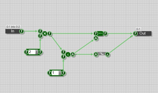

Just a simple interval indicator for my synths P3C knob later on.
Trivial and has surely been done a million times... probably just as many times better
Unnecessary amount of greens perhaps. I'm just to lazy...
Might be useful to someone else.
Can be used as a regular marker or modulation indicator for knobs if steps are increased a bit. Redraws are limited to the integer change.
