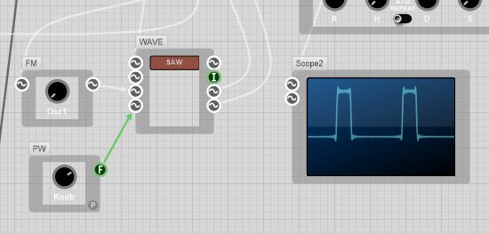

I actually experimented with saving some of them as .txt and float arrays to use with the Wave Table Read osc, but of course without the additional processing many don't sound right and don't change at different points on the kybd. The ones that do sound more or less right are still fun to play with being phase modulated, though. The phase input also allows for PWM (with a pair of oscs), which of course with other than saw waves is really just a very pleasant swirling phase sound; more effective on some shapes than others. Sometimes sounds a bit like a Leslie speaker. And 'PW' being swept by an EG can also sound quite nice.

Does PW/PWM with the saw wave. PWM (with PW at 50%) on the 'SAW 2' wave sounds very Hammond / Leslie-like 8-)

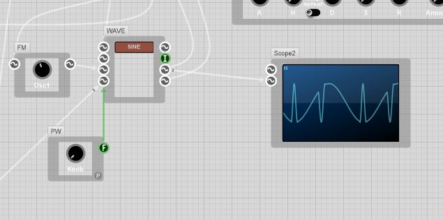

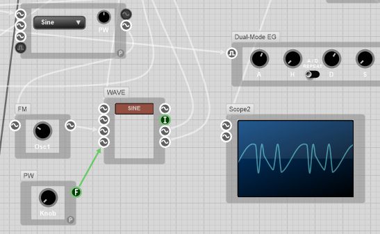

FM (audio rate modulation of phase) behaves very differently from a regular sine osc, and at moderate amounts creates some very sharp edges on the waveform. Almost looks like a Casio Phase Distortion wave.

I don't really follow what you're saying, but this version still double triggers the one-shot waves, and the FM is maybe worse; more symmetrical, but with deeper, narrower spikes:
Testing the FM is simple. In the screenshot you see an amp marked FM; it's input is just connected to the output of a sine oscillator. The SQ osc sine is at wave index #2
To test the one-shots, they are #54 thru 74.

It's interesting that the deep spikes with FM only occur when taking the output from the osc directly. If taken from the output of the stream subtract used to do the PW with a pair of osc, the spikes are gone, but the FM forms flat spots that FM with regular sine oscs doesn't have.
