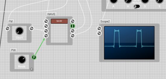

Does PW/PWM with the saw wave. PWM (with PW at 50%) on the 'SAW 2' wave sounds very Hammond / Leslie-like 8-)
SQ PW.jpg (22.55 KiB) Viewed 358563 times

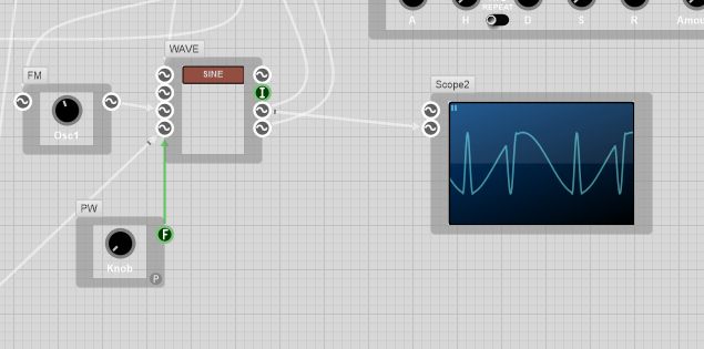

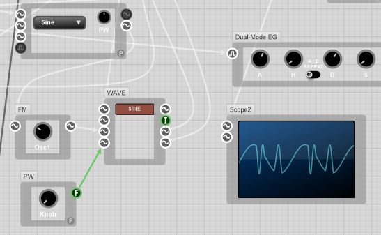

FM (audio rate modulation of phase) behaves very differently from a regular sine osc, and at moderate amounts creates some very sharp edges on the waveform. Almost looks like a Casio Phase Distortion wave.
SQ FM.jpg (32.22 KiB) Viewed 358563 times

I don't really follow what you're saying, but this version still double triggers the one-shot waves, and the FM is maybe worse; more symmetrical, but with deeper, narrower spikes:
Testing the FM is simple. In the screenshot you see an amp marked FM; it's input is just connected to the output of a sine oscillator. The SQ osc sine is at wave index #2
To test the one-shots, they are #54 thru 74.

Thanks all for gnawing at this - can't follow the discussion as it's far above my head, but here's the little test schem using the Razorblade osc.
It's interesting that the deep spikes with FM only occur when taking the output from the osc directly. If taken from the output of the stream subtract used to do the PW with a pair of osc, the spikes are gone, but the FM forms flat spots that FM with regular sine oscs doesn't have.
