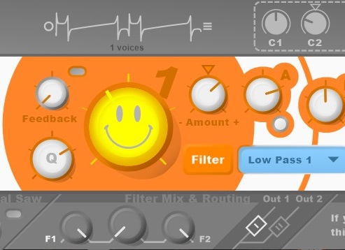

Posted: Wed Aug 30, 2023 8:27 pm
by R&R
Hmmm. I recognize that shape :P
Not nearly as sweet sounding and also somewhat transitory in my synth though... :roll:
I am not using the waveshape osc at all... but instead one of his other osc's, so I guess I have a ghost in my newbie synth. MV is haunting my synth.
Spooky action at a distance I think Albert called it? :lol:
It might be the hundreds and hundreds of hoping dezippers of his 8-)
