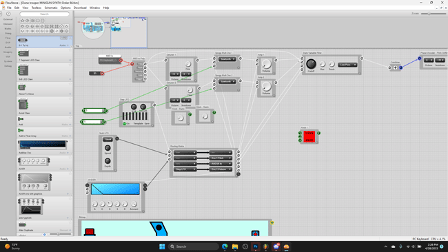

My major problem that stumped me right now is AHDSR Retriggering with my Step LFO. My AHDSR is attached to a pitch in the matrix. My step lfo is attached to the OSC Volume. Goal is to retrigger the AHDSR with the Step lfo so that it constantly shoots the adsr pitch as well as shooting the volume gate.
I just cant figure out how to retrigger the AHDSR with the Step LFO in the matrix. Idk if im attaching things wrong or what but its a major part of this synth and i cant figure it out.
Plz help
Plz help

Could you please post the schematic itself? Then we can offer help.

To trigger an envelope you need to set the envelope to Gate (in properties view) and supply a stream Boolean signal.
I’ve made a simple DSP which triggers the envelope when the Step sequencer output goes above zero. I set the matrix to control the pitch so you could hear the result. If adjacent bars on the step sequencer are set above zero you only get one env trigger until a zero bar is encountered.
Maybe this will give you an insight…
