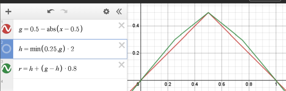

Refrac being just this image :

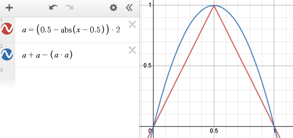

So now it's just a simple refrac value that blend the sinc coefficient with the linear one.
Like in the image.
They might exist other way and more precise way to do..
But this one seams a good ratio of precision/cpu.
Like in the image.
