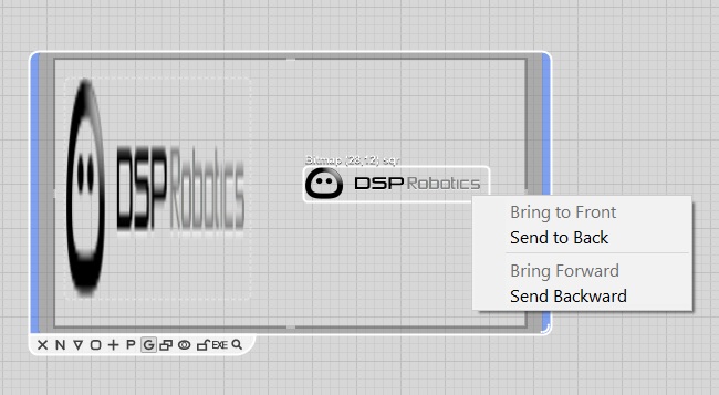

i add a bitmap and put my photo. In gui mode you can right click the image and send it forward or back.

But if you just want a bitmap background in a module/plugin. Place a toolbox bitmap module inside the module you wan't your background in, and make sure you send that layer (mgui) to the back.
