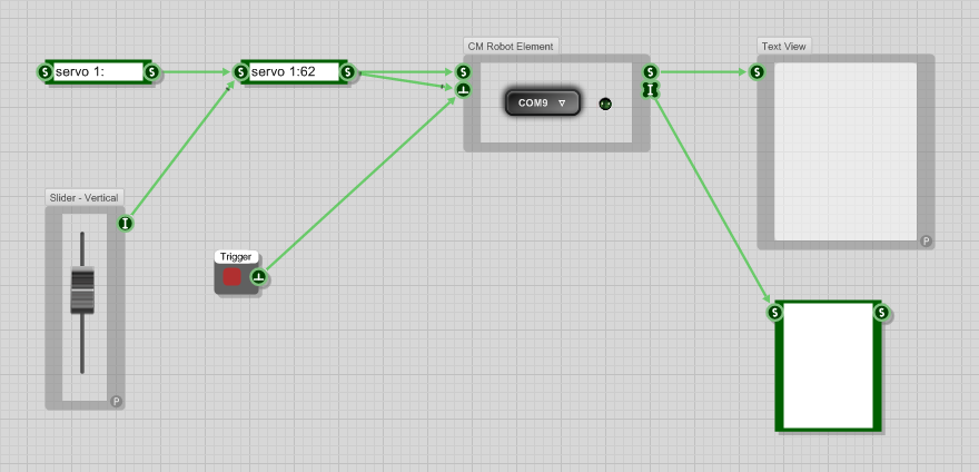

Here's an example of how to communicate with the cmRobot Element board:
cmRobot V1-00 clip.png (43.45 KiB) Viewed 93264 times
To communicate with this board you just need to send the text strings out to the board defined in the Element user Manual: https://files.secureserver.net/1sQYSKgeMb8fdZ
In this example we show how to control a servo.
cmRobot V1-00.fsm
(38.03 KiB) Downloaded 5574 times
