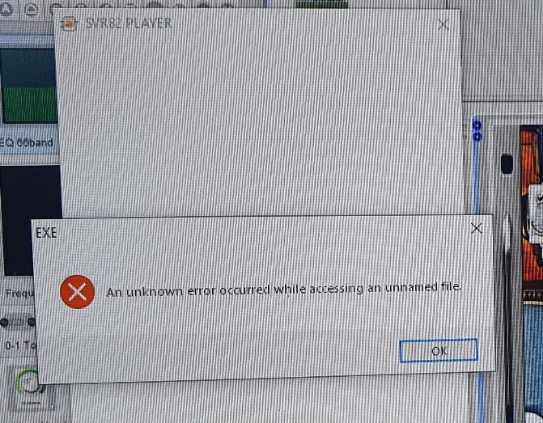

Error text
Error text
Hi guys. I know and create vst or standalone since synthmaker times. But now i have problems to create my own effect. Someone could help me? The effect run on flowstone but when i export to VST or .EXE and run the aplication or .dll happen the same error text.

Seriously now, I don’t know what this could be but as a start we would like to see the schematic if possible. Also what version of FS are you using? Hopefully not the 3.09 betas available on this site.

Talking seriously, my version of flowstone is a old 3.01 snowflake! The effect is a junction of models maded by users of dsp robotics forum with some simple mods and logic that i have maded.
Is a simple wave player with impulse response loader to make the Riaa REVERSE curve for cut or emboss vinyl disc's! I have 02 vinyl lathe at home and before you record we have to prepare the audio file.
This plugin make easily all the process of riaa reverse curve and make all freq. below150hz keeping mono because this process(cut or embossing) need this detail .

Hi spogg! Its running now. I just install a recent version of flowstone (3.0.8.1) and the .exe is complete functionally! And dont worry, now i will make more presence on forum. I have old project's( synthmaker and flowstone) to post . Simple ideas of a guitar amp.
