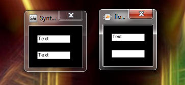

Hi there!
Well i thought it was a Ruby error that was causing this weird switching effect with your txt vanishing from the edit boxes so i imported the old edit box from Synthmaker which does not have Ruby into flowstone and it still happens but, if i export the very same setup out of Synthmaker the effect is gone!
i have exported the two exe's so you can see that SM edit Boxes work in an SM export but not from a flowstone exe proving that it is not you it is a bug in flowstone itself
now you can post a msg for the devs and do your first bug report!
hope this helps
hope this helps
