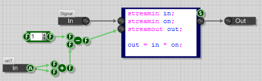

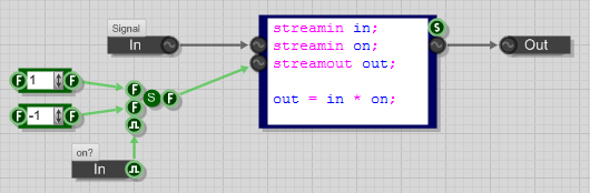

Re: Polarity Inverter
Tula, about your inverter: nothing wrong with the code, however you could avoid the switch, which will interrupt audio and recompile te entire schematic on switching. My proposal would be this:
or, if you don't mind the little hack, this:
martinvicanek wrote:Tula, about your inverter: nothing wrong with the code, however you could avoid the switch, which will interrupt audio and recompile te entire schematic on switching. My proposal would be this:
I love solution 2! It shows once again, what is doable if you have a "behind-the-scenes-view". Of course, a boolean converted to float is 0 or 1, and so it makes sense immediatly.
Is the selector always causing the stream section to recompile? It it the reason, so many people had issues with recompiling? If I remember correctly, the multiplexer does not cause a recompile?
Thank you very much, I will update the module!
