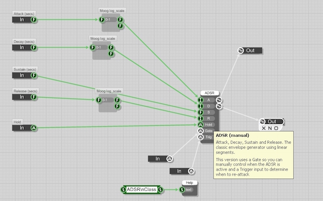

On an unrelated matter, I'm probably the last person on the planet to realize that the old EG prim that had a trig input (ADSR4?) doesn't show up in FS4. I just discovered none of my synths that have LFO trig and AD loop that used that prim no longer have those functions working. Is there a current FS4-friendly EG that can be triggered by the LFO and cycle the AD stages (act like an LFO)?

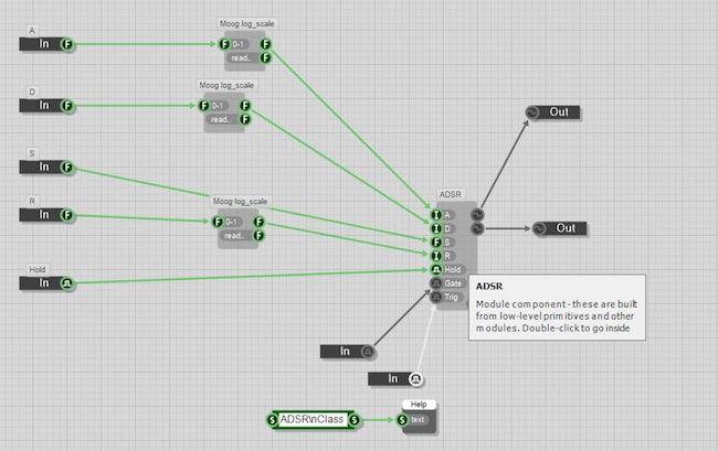

Yeah it's weird, in every schem I checked that had the ADSR4 prim in it had a different one in it's place when opened in FS4.
I'll post schems tomorrow - bedtime . . .

I don't remember how to get on/use Discord (never use it), so I'll just post the screenshots, if they're of any use.
I remembered wrong, it's the 'ADSR (manual)' prim not the 'ADSR4' prim that's getting auto-replaced by the module shown, when schem is opened in FS4.
The attachment Orig.jpg is no longer available
Which looks like this inside:
In FS4.jpg (48.05 KiB) Viewed 15352 times
As you can see my beloved little 'Trig' input has nowhere to go! ; - (
I'd been using the Trig input to do LFO triggering, and the 'Stage' (lower) output of the prim to do 'AD Repeat' (cycling) function.
