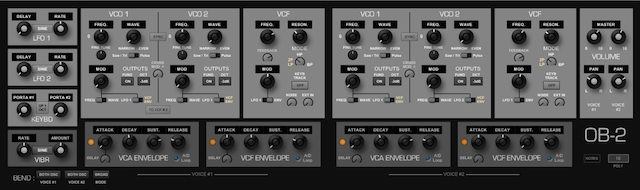

I did an update to OB-2 with enhanced envelopes; they are now exponential and have delay and A/D Loop (when either of these is used the EGs are linear).
More importantly, I gave all the controls unique Preset names - let me know if this makes the Presets work in a DAW, or if more needs to be done.
