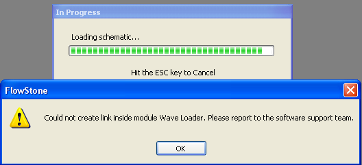

I got issues here....couldn't open FSM.....locked up CPU, force re-start...???????

Old SM Wave player module creating a problem . . .
Updated here, you should export to vst to check it out.

Drnkhobo wrote:Updated here
Cheers mate, thanks for that. File opened + saved..all good.
