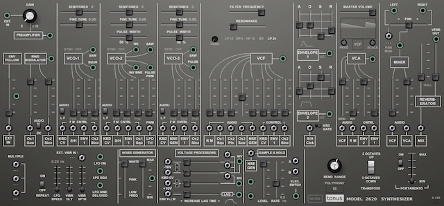

Tonus 2620 reverb fixed - total oversight on my part.
I set up the keyboard track to be on or off as you wish. The 2600 automatically turned off the keyboard when you switched to LF mode (the Odyssey, also). Since keytrack of 'LFO' rate is sometimes wanted, I implemented the keytrack as on or off at will - the far left CV input 'KBD' can be turned on or off by clicking on it's jack. I know it's not strict emulation, but I liked having this option easily available.
tonus 2620 copy.jpg (179.12 KiB) Viewed 28493 times
