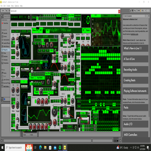

I've created several 64 bit plugs and the results are always the same.
In Reason, they run Flawlessly. :D
In Abelton Live, the graphics are completly F**ked so it's un-useable :cry:
In Fl Studio, has the worst result, where the plugins don't show up at all, not even in the browser. :cry:
WARNING :!:
Also After installing FS4, my FS 3.06 toolbox went straight to hell... :evil: ..I'm trying every trick in the book
to get it back, my beloved 3.06 Toolbox, where all my memories are, but nothing's working yet. :lol:
The last resort is Ok, keep FS 3.06 and FS4 on separate computers, so there's no problem there. :)

billv wrote:In Abelton Live, the graphics are completly F**ked so it's un-useable :cry:
Curious... What happens to the plugin-graphics in the DAW's that actually manage to load the plugins?
Do you have a screenshot?
Try an instance of my plugin (Might take a moment to load though... It's simply the way the plugin is :roll: ). Same result?

R&R wrote:Curious... What happens to the plugin-graphics in the DAW's that actually manage to load the plugins?
Re: Flowstone 4 alpha (FS4)
Posted: Wed Mar 27, 2024 10:40 am
by R&R
Looks like drawing origins are all over the place somehow :D
Hmmm... :?
Did you try my plugin?
"If" my plugin worked for whatever reason... You can try the following:
1. Create new empty project in FS4
2. Make an empty module with FS4's new MGUI inside and and then input for MIDI and the Left,Right outputs
3. Open up your old plugin in with FS4 and copy-paste it's entire upmost top module inside this new empty FS4-module
4. Connect input/ouputs as needed including wireless to the MGUI so your plugins shows correctly in FS4
5. Export and test with DAW...
6. If that didn't work, also test and allow DAW host to resize plugin window

Thanks for your ongoing help, I have got some good news. :D
In abelton live, in the Options/preferences/Look and Feel.... they have a button that's dedicated
to screwing with the graphics.: HiDPI Mode....turn this off....and problem FIXED.
All the synths(12) in the VST2 folder run Flawlessly.
