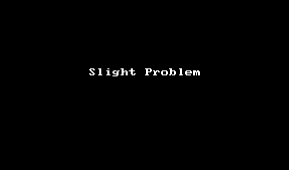

It would need some restrictions so this cannot happen.
Slight Problem.gif (2.34 MiB) Viewed 17588 times

lalalandsynth wrote:It would need some restrictions so this cannot happen.
Yeah, but in the case of colours I mean; figure there is no functions all of that data is on the same page. People say "colour" what if colour is just a bunch of ones and zeroes added to the sound?
I think it's as simple as that. But beyond that, the scaling is really only there for the developer. Once You decide on the scale then flowstone can scale it as it usually does. To make it a perfect science would involve more math. But, I mean as a designer; the ability to move a bit here and there without having to reposition everything? priceless.
