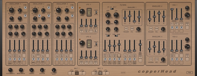

Anyway, no big tragedy - what I was working on was going to be my swansong anyway. A mashup of functions from ARP 2500, 2600, Odyssey, the CMS 2607 and a couple of ideas from Macbeth's 2600-inspired M5. All wrapped up in my favorite new GUI, the copper panel with 'Bakelite' knobs. Calling it copperHead.
