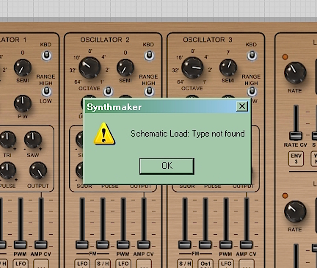

But now, - HELP! This is probably an ancient complaint, but what makes this appear? I'm now locked out of all my schematics. I open a project I was working on just last night, and -
typeNotFnd copy.jpg (314.33 KiB) Viewed 30447 times
'Type not found'? - isn't there only one type of SM schematic? Can't even close the program when this happens, I have to Task Manager out of it. Happens on every schematic I try to open. The schematic itself is OK, it opens fine on my other computer; but this one has my best-stocked toolbox. Does this mean I have to re-install the program, which I assume will mean I lose everything in my toolbox? SM Pro 2.0.5, in case it matters.

that error is when the schematic is made in a newer version of SM.
Have you tried uninstall,reinstall 2.0.5- ?
k brown wrote:But now, - HELP! This is probably an ancient complaint, but what makes this appear? I'm now locked out of all my schematics. I open a project I was working on just last night, and -
Did you try to delete the contents of the Recovery folder?
C:\Users\YOURNAME\AppData\Roaming\Flowstone\Recovery
Obviously it won't be under "Flowstone" and I'm not sure that Synthmaker does this anyway, but if you have such a folder, and there's something in there, it's probably a corrupt schematic. Just delete what you find.
I found with Flowstone that if you do need to re-install it you won't lose your toolbox. But back it all up first!
