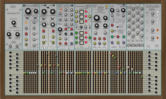

On a cheerier note - I completely re-built the patch matrix on my ARP 2500 emulations. I'm embarrassed to admit I never checked the Preset save/load on these and it didn't work! After much head-scratching, it seemed to be the vertical vector sliders I'd used to simulate the 2500's matrix slide switches. I'd configured the sliders as 22-position switches and that seemed to be the problem (and source of sluggish/twitchy action). When loading a saved preset, all the sliders would get set to the correct position, but the connections wouldn't be made. Only after moving both input and output switches off their position, then back again would the connection 'take'. So I replaced them all with multi-position push-button selectors with their bitmap buttons replaced with proper slider-cap images. Had to compromise the emulative 'slide-switch' behaviour; now connections are made by clicking on the switch's track where it crosses the patch buss at the desired point and the knob moves to that point. It's actually faster and easier, but a less 'authentic' experience.
Only three converted so far - 'Nineteen70', 'Left Wing' (the left 'wing' cab of Pete Townshend's 2500), and 'OdyWing' (that has modules selected to provide the basic functions of the ARP Odyssey). Most of the 'Nineteen70' 8-module builds have in the mean time been converted to drop-down patching till I get 'round to replacing their matrix-patching.
tonus Nineteen70_650.jpg (306.95 KiB) Viewed 30401 times

k brown wrote:On a cheerier note - I completely re-built the patch matrix on my ARP 2500 emulations. I'm embarrassed to admit I never checked the Preset save/load on these and it didn't work! After much head-scratching, it seemed to be the vertical vector sliders I'd used to simulate the 2500's matrix slide switches. I'd configured the sliders as 22-position switches and that seemed to be the problem (and source of sluggish/twitchy action). When loading a saved preset, all the sliders would get set to the correct position, but the connections wouldn't be made. Only after moving both input and output switches off their position, then back again would the connection 'take'. So I replaced them all with multi-position push-button selectors with their bitmap buttons replaced with proper slider-cap images. Had to compromise the emulative 'slide-switch' behaviour; now connections are made by clicking on the switch's track where it crosses the patch buss at the desired point and the knob moves to that point. It's actually faster and easier, but a less 'authentic' experience.
https://ln.sync.com/dl/2d41fb1a0/9tvgpf ... 9-hcprkgfk
Beautiful! Will have fun with this tonight. :)
