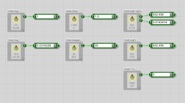

I'm posting a .fsm containing a few knobs derived from Nubeat7 initiative, no more Trigger Galore, debugged by MyCo. They are all different, featuring different transfer functions. In the properties you can change the colors and other details. I wanted them to be as simple as possible. There is no MIDI support.
knobs properties.png (31.1 KiB) Viewed 29570 times
knobs (Nubeat7 steph_tsf MyCo).fsm
(6.56 KiB) Downloaded 1433 times
