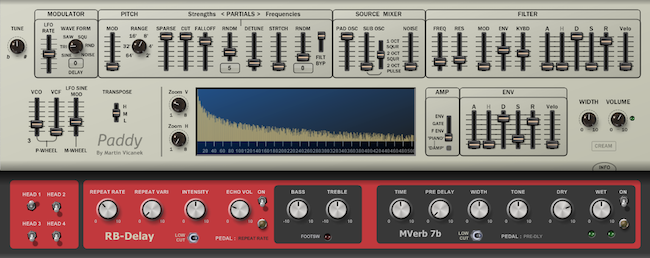

Here's what this is looking like - lots of functions added; based loosely on the SH-101. Martin's presets are retained - added a few of my own; and a bunch by Manfred Plummer.
Paddy copy.png (163.01 KiB) Viewed 20758 times

Hey Kevin, that's a very cool looking GUI! :D
k brown wrote:PadOsc722 looks to have a stereo structure internally, but all the presets are mono (?); and I don't hear the Width control having any effect.
Damned, another bug. Will fix that over the weekend.
