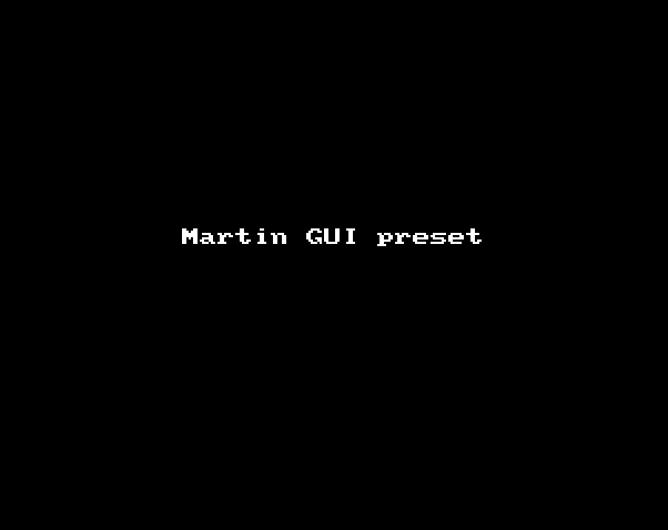

Might implement this custom dropdown.
Depends on if the preset count is capped at something sensible.
Martin GUI preset.gif (108.89 KiB) Viewed 16817 times

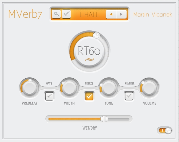

lala, I was curious, is that GUI images? The reason I say is it could reproduced quite easily with only shape prims. I could mirror Yours if You like with only shape prims. The lines would be crisper.
It's the least I could do; I used to work with HTML You see, it's a different skilllset. Up to You, the lines would be sharper though.
Posted: Mon Jun 03, 2019 4:34 pm
by lalalandsynth
Yes , sure , if you think it can be recreated ,why not ?
Although it is a bit crisper then shown on the gifs .
Even a bit crisper then on this jpg.
Mverb 7.jpg (87.16 KiB) Viewed 16799 times

lalalandsynth wrote:Why is the Gate function a 3 state switch ?
There is a short and a long variant. It is not exactly gated, it is actually truncated.
And how does the Tone shaping work ?
There is a leaky integrator in the feedback loop. The control value is sent through a mapper so that the effect is perceived as half way at the 12 o clock position.
I guess the pre delay numeric value is in samples at the moment ?
Yes
Also need a volume control and wet/dry.
I could make those unless you want to make them yourself Martin or Spogg ?
I'd say go ahead and allow me som testing and possibly modification at the end.
Also , a lot of artifacts when moving the Pre-Delay.
I have a solution for that.
And quite a volume jump when i hit Freeze.
:o Not in my original post, though.

I'd rethought My method of creating a way to match an existing drawing. I have in mind something even better though. Right now it's a two step process, but now it will be just enter the exact pixel of x y, width and it will automatically vector scale.
It's really quite intuitive. I'd realized I'd need to use a scale, tried a few and settled on Trogluddite's float scaler. It works incredibly well.
So, I'll set the original images (the jpeg lala uploaded) width and height to a wireless and that will translate using a float scaler to the pixel values supplied to My new Area margin / scalers / vector scalers.
