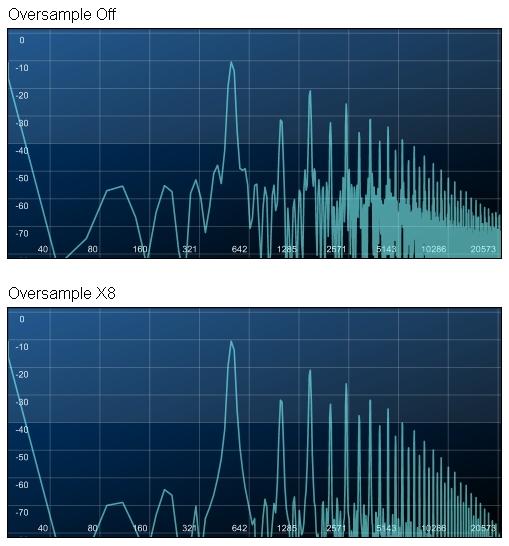

Re: FINALLY - a way to to OVERSAMPLE your schematic for real
I used your oversample in my overdrive. Thanks KG !
- Oversample_Off_&_X8.JPG (42.3 KiB) Viewed 40865 times
