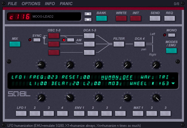

A fabulous-sounding plugin called SQ8L, which is an apparently very accurate emulation of the Ensoniq ESQ-1/SQ-80 is no longer being developed. Despite it's accurate emulation and great sound, I find it's interface to be slavishly imitative of the hardware and not very pleasant to use - with hard to read 'fake' LED numeric readouts and many sub-menus, etc.

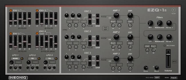

Here's my schematic (the more 'mature' version with standard 'analog' style oscillators):
Insoniq EZQ-1a.osm
(1.14 MiB) Downloaded 1360 times
Insoniq EZQ-1a copy.jpg (34.85 KiB) Viewed 28738 times

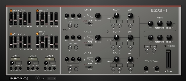

Here's the original version I did with the wavetable oscillators, though it hasn't yet been updated with a few refinements I made to EZQ-1a:
Insoniq EZQ-1.osm
(519.02 KiB) Downloaded 1382 times
Insoniq EZQ-1 copy.jpg (90.87 KiB) Viewed 28738 times
