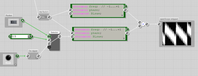

Since I'm the dope without FS, let's do this the other way 'round. Here's a schematic of my situation. With a 0.5 float - perfect square, with a PW control, a saw on acid. Maybe it's not the same saw you guys are using.

In general, is there an advantage to doing PWM with a steam subtract rather than mixing the phase-shifted saw through an inverter?
It's the same thing.

The problem in your schematic was a faulty phase implementation :oops: Fix attached.

So!- the code I had was different; I thought I'd lost my marbles. Thanks so much for fixing that.

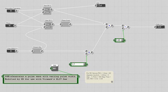

So, I tried your saw with the 'fancy' pwm (stays-centered) method and it didn't work! I noticed your oscillators have a different phase relationship to the stock oscillators. Here's how I modified the PWM to work with your oscs.
Centered PWM wVicnak BLIT Saw copy.png (109.7 KiB) Viewed 28514 times
Does this have DC on the output?
Posted: Fri May 04, 2018 2:21 am
You can easily measure DC by placing a lowpass with sufficiently low cutoff. ;)

Posted: Sun May 06, 2018 5:43 pm
I put a couple of u-he synths on a scope and they don't keep the pulse waves centered with varying width, so probably safe to say it's a non-issue in the real world. On some, the scope in the plugin itself shows the waveform staying centered, so it must be receiving a 'corrected' wave so it 'looks nice' on the scope. I do use the centered, unipolar version in LFOs though, so the pitch stays 'tuned'. It's interesting that there seems to be no consensus regarding unipolar vs bipolar on LFO waveforms in the synth world hardware or software. Dave Smith's LFO waves are all uni except Sine and Tri, none of u-he's (of the ones I checked) are uni, the ARP 2600 hardware - same as Smith's. Same with 'voltage' ranges of LFO waves; Smith's are +/- 5v on the bi-polars, 0-5v on the uni's while others' are 0-10 on unis, ARP Odyssey's are all over the place, etc.
