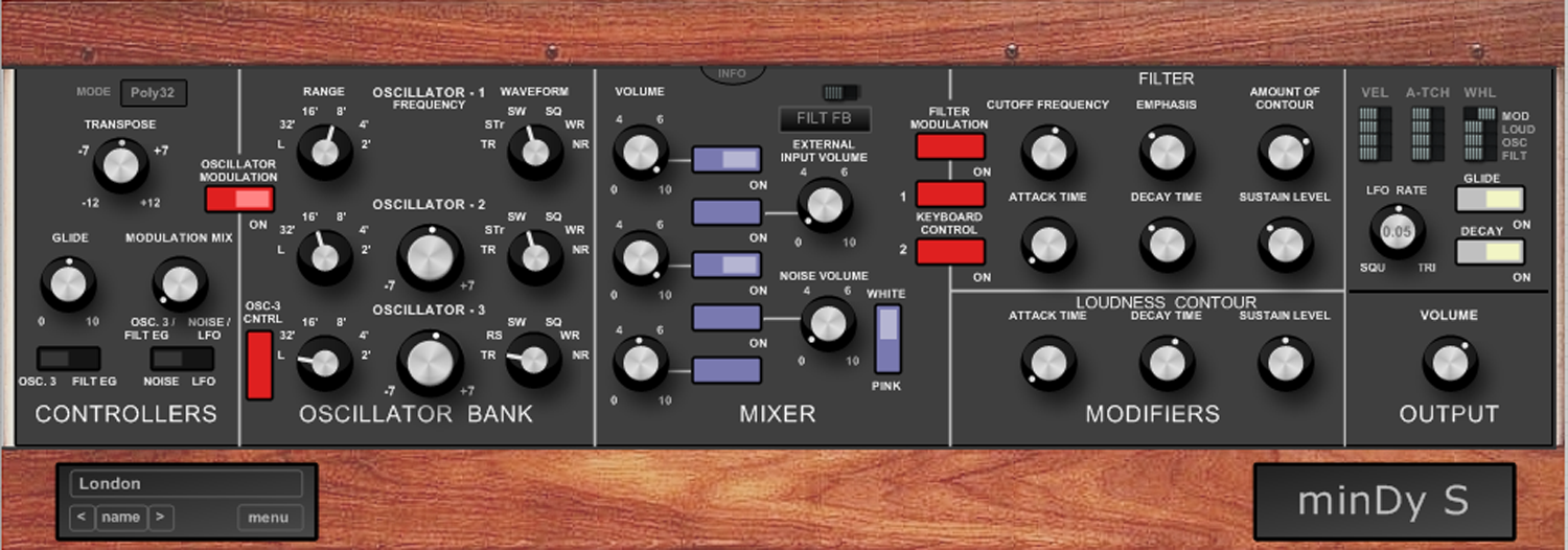

Hi guys
I’ve been having fun with one of Kevin Brown’s synths; the minDy.
Kevin Brown created a wonderful synth, heavily inspired by the Minimoog. He did all the hard work but I was inspired to “enhance” the sound by adding my analogue modelling modules and techniques. I’ve had the cheek to name it minDy S too!
I’ve made use of Martin Vicanek’s excellent and CPU-efficient oscillators, but the CPU is a little higher than the original, due to the modelling overhead. If that’s important for you then use his original one.
You can get it here:
EDIT: this now has its own topic with new versions and lots of nice banks to play with:
viewtopic.php?f=3&t=40801#p119718
This is a list of the changes made:
• Oscillators 1-3 now use analogue sounding enhancements. These include a low level noise component, free-running emulation, minor scaling “errors”, slew rate emulation and wave-shaping based on published waveform images.
• Replaced the filter with an emulation of a 24dB/Oct low pass ladder which can be “overdriven” and can self-oscillate.
• The envelope generators emulate the original Moog shape and behaviour. The attack section is about 0.6 of an inverse exponential curve and the decay and release are exponential. The famous "snap” is also modelled.
• Added a front-panel preset manager with several generic presets.
• Oscillator’s tuning corrected to +/- 7 semitones (was -12 to +7) and centre detent removed to allow for finer detune settings. The zero position can now be set using a double-click, as well as the original cntrl-click.
• Internally changed the frequency modulation to emulate 1V/Oct behaviour which allows for real FM and equal pitch deviation across the whole keyboard range.
• Corrected the Low Frequency settings for Oscillator 3 so no “negative” frequencies (phase inversion) are created below the centre fine tune position. Changed the rate range to 0.1 Hz – 20 Hz.
• Changed the “pressed” colour on the red rocker switches.
• Used Martin Vicanek’s LFO oscillators for the separate LFO and halved the output swing for better modulation control range from the mod wheel.
• Some changes made to internal levels to suit new modules.
• Added vintage analogue electronic noise and hum at a very low level.
Kevin, please feel free to add this to your ever-growing archive if you wish. Also I’d like to feature it on Flowstoners under Flowmates, but only if you think that’s acceptable.
Posted: Sun Apr 15, 2018 8:08 pm
Wow - amazing!
Some very nice presets.
A couple of requests, if you care to:
- Re-do the Preset Manager to the dark, skinny bar below the GUI (as on most of my other stuff), so as not to mar the walnut panel.
- Possibly remove the Wheel switches at the upper right (and add Vel and AT sensitivity controls), as I did on my update? :
"Slight correction to minDy in the spirit of hardware emulation: the wheel switches have removed from the bank at upper right because neither the original nor the re-release had output jacks for the wheel. To approximate the new 'D's 'Mod Source' rear panel jack, when the Velocity and/or Aftertouch switches on the 'Mod' line are activated, those CV sources replace 'Noise' in the Mod Mix, and the labels there change to 'Ext' to reflect this. Also added Vel and AT sensitivity controls".
Otherwise, yes do with it as you like.
This is great, thanks for doing this. OK if I put it on my website?
Posted: Mon Apr 16, 2018 8:24 am
Hi Kevin
I was never really too happy with the preset manager placement actually, so I’ve done what you asked and re-worked it in the style of some of your other synths.
I looked inside the minDy 2 and it’s certainly great and more flexible, but I decided to stay with the version that inspired me to do the work in the first place. I actually like the simplicity and the creative challenges it brings. Since I called it the minDy S it’s differentiated from your first and later iteration too.
Bob Moog certainly knew what he was doing and achieved so much with so little, and I like that ethos. These days we have the luxury of creating mega synths that do so much (too much sometimes, in my view) but the Minimoog is a design classic that provides all the essentials, looks good and is easy to operate.
I hope I haven’t disappointed you, and if not, please consider this to be a gift in return for all you’ve shared with us. If you want to share it on your website please go ahead; I would be honoured.

Posted: Mon Apr 16, 2018 10:04 am
Spogg wrote:I was never really too happy with the preset manager placement actually, so I’ve done what you asked and re-worked it in the style of some of your other synths.
Ahh, that's very nice thanks for doing that; I totally see your point about sticking to original minDy; would you consider adding the Velocity and Aftertouch sensitivity mini-knobs from the latest minDy update? - they are on the re-issued minimoog (back panel), so an 'official' enhancement.
Thanks again, and thanks to Martin for all his work you've been able to include.
