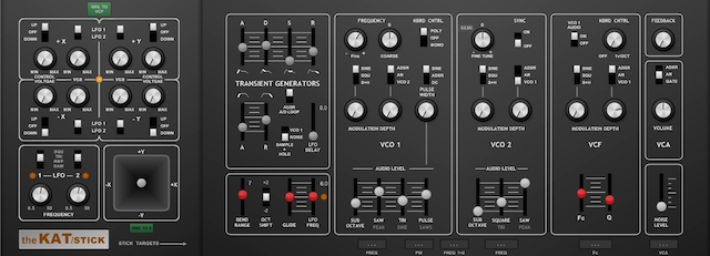

I've just completed an emulation of Octave's the CATstick 4-way joystick controller (theKAT/stick). There's just one of it's functions I wasn't able to figure out. Unlike most joysticks the CATstick was spring-loaded and returned to the center/zero output position when you let go of it. I'm using one of the X/Y pads that has a preset module in it that Spogg kindly sent my way, and already this has the ability to Default to center when you Cntrl/Click anywhere on the pad. What one needs here is for it to return to Default when you release the mouse button. I'm assuming this would be done with the Mouse LUp prim in the right place inside the schematic, but I've tried every place I can think of and I just can't get it to work.
I imagine this is pretty simple for someone who knows more about building with prims than I do.

theKAT/stick
the KAT-stick copy.jpg (105.24 KiB) Viewed 37131 times

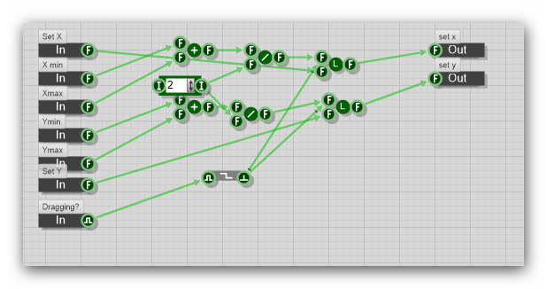

ok I use Flowstone 3.0.8 Skylark

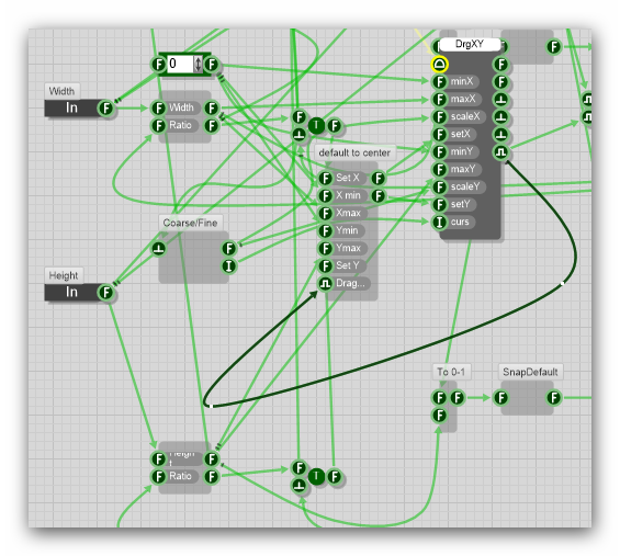

in module Pad Control
you need to create links from Xmin (=0), Xmax, Xset, Ymin (=0), Ymax, Yset, and dragging(primitive drgXY) to a new module named 'default to center'
The connections are a bit fuzzi but i did it quick en dirty.
Module PadControl
Module PadControl
In new module default to center
calculate the center for X and Y
if dragging change from true to false then the module set the X and Y position to center.
connect the X and Y outputs of the new module to the drgXY primitive.
default to center
default to center
default to center.png (38.54 KiB) Viewed 37112 times

Wow! I would have sworn it would be much simpler than that! - didn't involve the Mouse LUp; no wonder I couldn't figure it out, I was barking up the wrong tree.
Thanks so much for the screenshots; I think I can figure it out from these. I was also hoping to make the Default upon drag-stop switchable, but maybe not.
Posted: Mon Mar 27, 2017 12:18 am
F-ing brilliant - exactly what it needs to do; switching back and forth from 'normal' to 'spring-loaded' was as simple as switching off the Dragging.
Thanks so much again for your help. Now the KATstick can have a 'spring-loaded' joystick like the original, or a normal X/Y pad, no matter what kind of controller they're using! Great!

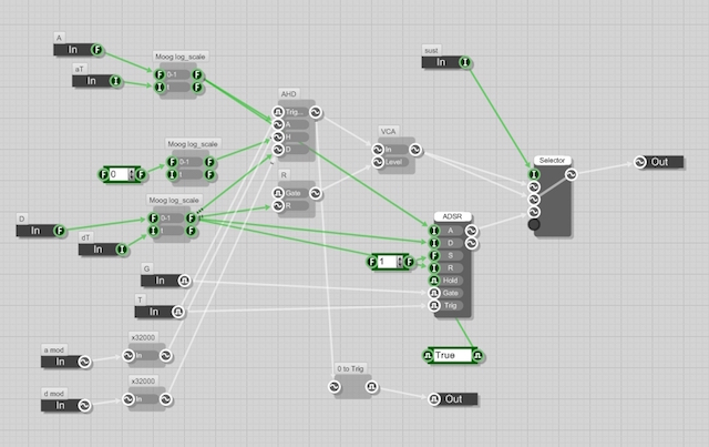

Back to the subject of envelopes that can have their times modulated and can be changed while the envelope is looping, I came up with a kludge that does everything required but has a nasty bug.

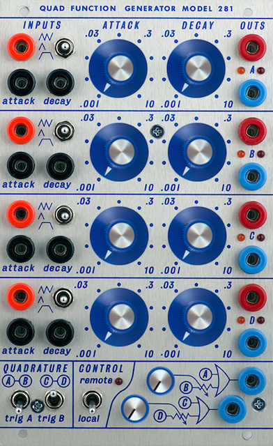

I built this to emulate as closely as possible the Buchla 281. These ASD (actually ASR) envelopes have three modes (toggle switch on the left):
repeat/(AD loop), transient (A followed immediately by D) and sustained (ASR).
Buchla 281 copy.jpg (191.77 KiB) Viewed 36835 times
As you can see in the photo, the Attack and Decay times have control inputs (the black banana jacks). There is a pulse (trigger) input (orange banana) for each EG, and each one generates a pulse at the completion of it's Decay stage (red banana). Using this crazy lash-up:

ASD Env-Buchla-style_640w.jpg (155.04 KiB) Viewed 36835 times
I've been able to achieve all these requirements, however in the specific condition of using one looping envelope to trigger another, there is a nasty random blip/click/thump if the looped triggering EG has a shorter decay time than the EG it's triggering. In the reverse condition, everything's fine. In the version of this envelope type (for my Dodecamodule emulations) that don't need to have modulatable AD times, I used the old ADSR (manual) prim and this problem doesn't occur. But it can't be used for this 281 emulation because only envs with stream inputs can have their times modulated.
My hunch is that the problem probably has something to do with the use of the 'R' module following the AHD - but I've no clue what to do about it.
Have there been any EGs built in the Flowstone era that have stream inputs to the time controls, and have both Gate and Trigger inputs? - I assume that's what's required here (though maybe only needs to have trigger input, since the AHD module used here only has a trigger input).

Posted: Wed Apr 19, 2017 10:07 am
I hit this issue when making my Quilcom Harvester!
The problem is caused by the AHD. It works in 16 sample increments, so fast re-triggering doesn't work properly.
I've changed one of the AHDs for mine and provided the AHD module at the top level also.
This one is fully evaluated every single sample so it uses a bit more CPU but no nasty clicks!
You can modify any code-based envelope generator this way if you need a fast re-trigger.
