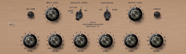

Or, in brushed copper - if you prefer:
Viola_copper copy.jpg (25.14 KiB) Viewed 17859 times

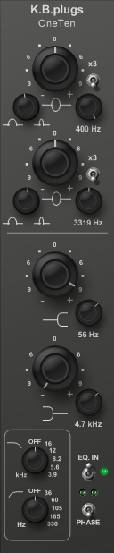

For those whom a vertical GUI better fits their DAW workspace, here's a vert version, laid out like the original 110s that were in the AIr Studios desk:
OneTen V.jpg (35.2 KiB) Viewed 17681 times

Re: New project idea
Look nice k_brown ...
but I wonder, on the Vertical layout, if the Low/Hi Shelf graphics are backward ?!?
Oops, nope - the graphics are right, but the Fr controls were backwards/in the wrong place.
Replaced in previous post, also.
