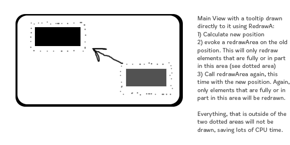

There might be a misunderstanding of the concept. To make absolutely sure we talk about the same, I made two (artistically impressive :P ) images:
Of course, that's just the theory. If Flowstone has this programmed badly, it won't result in more CPU time. But that's needed to be tested.

sure but if you watch the schematic you can see that only the small labelview is redrawn there is no redraw of the view where the mousemove happens and the knobs are placed, so i don't need any specified area to redraw..
it would be different if i would move a small label rectangle inside the the same view where the mouse move happens..
while with this technique the redrawing just for the little label rectangle is just a pita because it will leave the old rectangles all the time..
but i tried it anyways.. and i found another annoying thing with this :D if you touch a knob once, this knob will not react to its mOver anymore, what a mess, so the m over stays on :roll:
you can go inside the gui module and touch the knobs again, so they are sending the mOver off again, touched once on the upper levels the same mess again..??
you also can go inside the label where i commented the area for the redraw
in general i think the moving rectangle is a bit better in relation to the moving view, although i'm redrawing the whole view...
