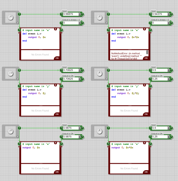

Posted: Sat Jul 04, 2015 8:08 pm
This simple piece of Ruby code won't work:
# input name is 'x'
def event i,v
   output 0, @x
end
Output is always zero, and there might be an error message or not. It seems to work with input names other than 'x'.

by MyCo
looks like @x is used by FS as a variable to store the main Ruby Thread... that's a bit stupid though.
