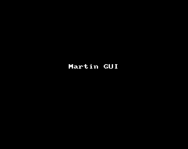

Final version for today , been at this all day , finally got everything working.
Question though , the Tone control , how does it work , lowpass , highpass , shelf ?
I guess I could test but would like to know as I might have to animate the knob differently if its Centered as default?
Martin GUI.gif (228.03 KiB) Viewed 18428 times
