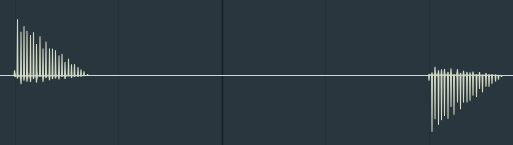

Edit: I just did a quick test, and if FS's "Delay" component is accurate, then delaying one signal by one sample and then mixing it with the inverse of the original is very much audible.

Thanks for the explanation. Was real easy to set up using your guide, but not sure about result.
I made vst of the test synth
Then i made another, and just deleted the timer/midi generator, so it uses the Host clock.
So both synths output exactly same, but one generated by FS Timer, the other by host.
I send both to individual tracks, and then routed both to a single track.
Then i click the little "invert polarity" button on one of them, a few times. here's result
Notice how it's not showing a note in at start of every bar?
Is this because both signals are so accurate they dissappear altogether when they phase back in?
Is this what you mean by
Perfect Human Interface wrote:achieving a perfect cancellation
So the actual result is this,
A missing note, with no artefacts, or bits and pieces left over, is that right?

by trogluddite
Yup, those 'missing' notes will be the ones that cancel perfectly, and the ones you can see are where there is a difference.
Before you go blaming your timer for the 'non-cancellation' though, you need to be careful to asses how the sound is generated, and the inner working of the sequencer.
If the subtracted values are very tiny (maybe you zoomed for the screenshot), it could easily be explained by interpolation of 'fractional' samples, or even some code somewhere in the test synth that is using hopping.
For example...
If the reference sounds are cut/pasted into place within the sequencer, they are most likely lined up exactly with sample boundaries, which might not always fall exactly on a beat (depending on tempo). So the placement has to round up or down to find the exact sample. Likewise, your synth will have to round the time to exact samples too - but may not necessarily be using the same form of rounding as the sequencer.
I'd try slicing up your test recording, and nudging the sounds in samples one way or the other to find out just how far out they are - and if it is an interpolation issue, you may find that there is not even a position that cancels exactly.
This is also why I prefer to use PPQ. When things are free running, you can still get drift even if the maths formula is correct in theory - it only needs the sequencer to do the calculations in a different order (swapping around the divides and multiplys, say), and the tiny rounding errors come out differently.
For example, in floating point maths, there is no guarantee that x / y = 1/y * x, even though maths theory says they should be exactly the same.
It could even be something as simple as one of them using single-precision maths and the other one using double-precision.
