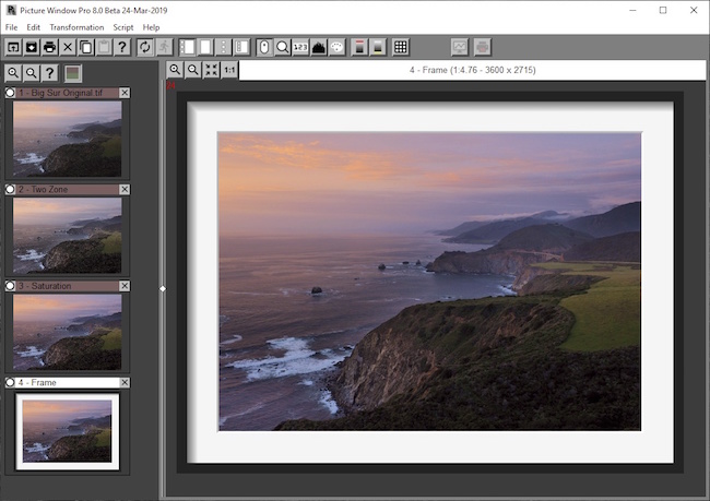

Slightly off-topic, but the discussion reminds me of my first, overwhelmed reaction to Photoshop. As a (almost literally) lifelong avid photographer, and having made my living for many years working in commercial photo labs, I found the interface and especially the terminology used, to be utterly foreign to me. It struck me as a software created by computer programmers, rather than photographers.
This is in stark contrast to a little-known software called Picture Window (not surprisingly, Windows-only), which was actually written by a photographer who had the same reaction to Photoshop that I did.
https://www.dl-c.com/index.htm/
The interface is much simpler, and the terms used make perfect sense to photographers. The workspace is way less cluttered, but it does about 70% of what Photoshop does, because it doesn't contain functions that are not directly related to the editing of photos (like a lot of the Photoshop tools that are much more graphics-oriented).
Picture Window.jpg (101.06 KiB) Viewed 15809 times

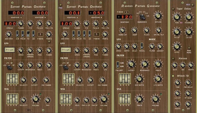

It also hits home because the project I'm finishing up now, has become rather 'over-knobby', but I can't quite figure a way around it. It's a (perhaps a bit over-stuffed) tribute to several of Martin's unique 'sound generators' that he's laid at our feet over the years: the Spread Partials oscillator, the padOsc, String Orch, and Random Partials oscillator (that came to be dubbed 'Randy'). Also includes, of course, Korous and MVerb7B. Spogg gave it a once over and corrected a few things, and Martin fixed an odd bit of code that prevented Randy from working in FS4. I'm calling it "the V-Suite". It's done and on my website, but I'm putting together some presets to add to it. I did the GUI up to look like a modular synth, although it's not one ;)

k brown wrote:It also hits home because the project I'm finishing up now, has become rather 'over-knobby', but I can't quite figure a way around it. It's a (perhaps a bit over-stuffed)
Hey thats nice!
Gives the feel of an instrument panel on boats/marine context with that brass/mahogny theme 8-)
Hmmm... I don't find it over-knobby at all :)
It might the the numbers around the knobs that causes the illusion of more knobs than there actually is?
An experiment you can always try... is to reduce the numbers around the knobs to quarter numbers only? 0-2-5-8-10
or perhaps dial back the color somehow of all numbers that aren't 0, 5 and 10... iow min,mid and max?
k brown wrote:...tribute to several of Martin's unique 'sound generators' that he's laid at our feet over the years
Martin is incredibly generous with his time and effort... I've been getting some help from him with my envelopes lately 8-)
Re: AHDSR into an AHD
k brown wrote:It struck me as a software created by computer programmers, rather than photographers.
I'd rather say, it is exactly on-topic, because this is the same point I made about the differences in FL Studio and Studio One.
The latter is at least heavily influenced by real musicians, the former a fantastic piece of work, but from developers with little or no understanding of musicians.
I see what you mean. It actually feels a little crammed, and you did your best to categorize and guide our eyes. From my perspective (a potential user), it needs more space. Whitespace is more important than people think. It calms down an otherwise slightly chaotic appearance. Since you decided to go with a vertical layout, I would give it more height and use it to leave more space between the sections. And since Randy differs from Spread partials, of which there are two, you could make the difference more prominent, by using a different colored background, or by making it wider than the two other OSCs. Lastly, I would remove the effects section from the main page and have a second page for it, where the layout would be horizontal with three sections. But that's just me.
One little thing, that confuses me right away, only by looking at the image, is the use of two identical knobs, both named "Cutoff" for the spread partials OSCs. You could rename it to make its function more obvious, like "to Cutoff" or "Envelope amount to Cutoff" (too long, but you get what I mean).

Agree about the numbers around the knobs - unfortunately they are an inherent part of the knobs' bitmap images, so can't be changed.
When I've used them on solid-color panels, I block out every other number with same-color ellipses, and/or darken the numbers with a same-color ring over the numbers with a low alpha, to darken them a bit. none of this is practical with the wood-grain photo background.
I'm experimenting with an alternate GUI for "the V-Suite" that has solid-color panels, so I can apply these 'clutter-reducing' tricks.
All good points - thanks for the input.
Not sure what you mean by 'whitespace'; more 'empty' areas?
I also noticed the two 'Cutoff' knobs so close together as to confuse. One thought I has was to add a BG 'stripe' of some sort, behind the EG-related knobs, emenating from the EG to make it clear they are all EG-amount controls. Also might be sufficient to simply rename the EG's Cutoff knob "Filter".
Making the GUI taller is also a good thought.
As to the FX section - I did consider making it a second page (still might; sharing that second page with the mod matrix [not seen on the screenshot]), but as to horizontal layout, I was trying to suggest the appearance of Moog-style modules, which were all vertical.

k brown wrote:Not sure what you mean by 'whitespace'; more 'empty' areas?
Yes, exactly. I wrote it wrong, its name is actually "white space". It's a term from designers (layout, UX, typography) and describes space between design elements, chosen for specific reasons. Here's a good intoduction into "white space", if you're interested: https://www.interaction-design.org/lite ... hite-space
k brown wrote:I also noticed the two 'Cutoff' knobs so close together as to confuse. One thought I has was to add a BG 'stripe' of some sort, behind the EG-related knobs, emenating from the EG to make it clear they are all EG-amount controls. Also might be sufficient to simply rename the EG's Cutoff knob "Filter".
A perfect idea! Much better than just renaming! Please do so!
k brown wrote:As to the FX section - I did consider making it a second page (still might; sharing that second page with the mod matrix [not seen on the screenshot]), but as to horizontal layout, I was trying to suggest the appearance of Moog-style modules, which were all vertical.
Totally understandable. My suggestion came from looking at the amount of knobs, that would be easier to read in a longer horizontal line. But it is just a suggestion. And just moving the effect part to a second page already helps a lot, regardless of layout!
I'm curious about the result!
